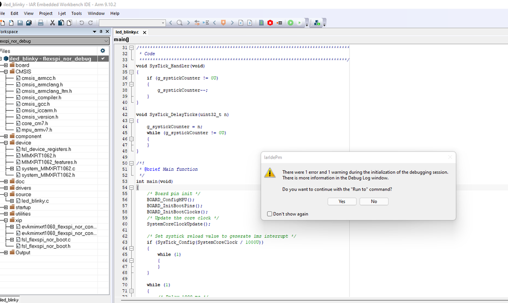

I intend to use the MCU MIMXRT1061CVL5B, and now I am examining its compatibility with the product's functions using the MIMRT1060-EVKB. One limitation that I have is the use of the OpenSDA, therefore I checked if I can boot the external flash with the USB-OGT and I was successful to do so using the flashloader with the elftosb and the MfgTool2. My question is, as in the development phase I need to run debugging sessions, how is it possible to do so from the external QSPI NOR Flash?

2,767 Views
Lukaz
Hi Kerry,
when I run the debugger session I get this message and I press yes to proceed and the debugging session works fine image.png
but I was wondering if you have any idea why am I getting this message (below is the error message from the debug log)
2,756 Views
kerryzhou
Hi @Lukaz ,
   As I know, it is related to the IJET, as when I use the CMSIS DAP debugger, which is the RT1060-EVK default debugger in the IAR, it doesn't have this issues.
  So, you can ignore that issue, just use it.

2,773 Views
Lukaz
Thank you, it worked fine with me using I-JET debugger.
Just some points to clarify the solution. I have not disconnected any jumper from the board, I have connected J1 3-4 to use the USB-OTG port for power. The important thing was the debugger configurations (see screenshots below)image.png
