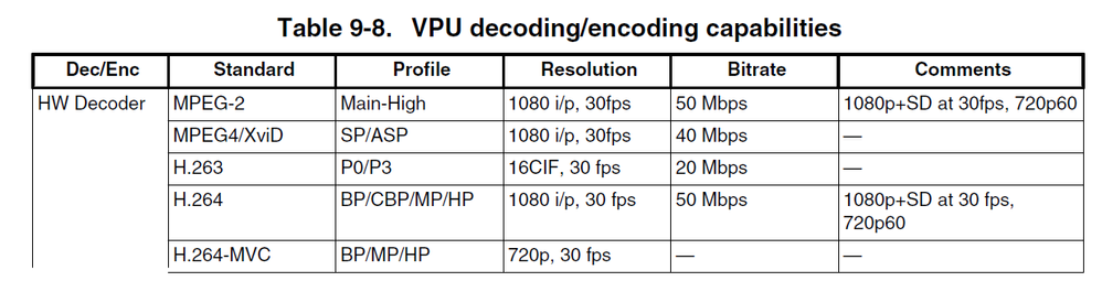

Using MCIMX6Q6AVT08AE hardware to decode wifi camera data, the camera data video stream from 1080P to 720P green screen will be reduced, is this processor's hardware decoding capacity is insufficient?

About the i.mx6q VPU decode you can see this Q&A: MX6 VPU H.264 Dual Stream Encode Limits , hope this can do help for you.
