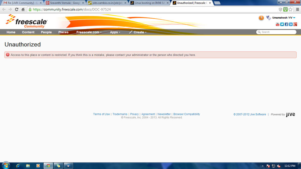

bottleneck
But it is restricted. Please check the screen shot.
