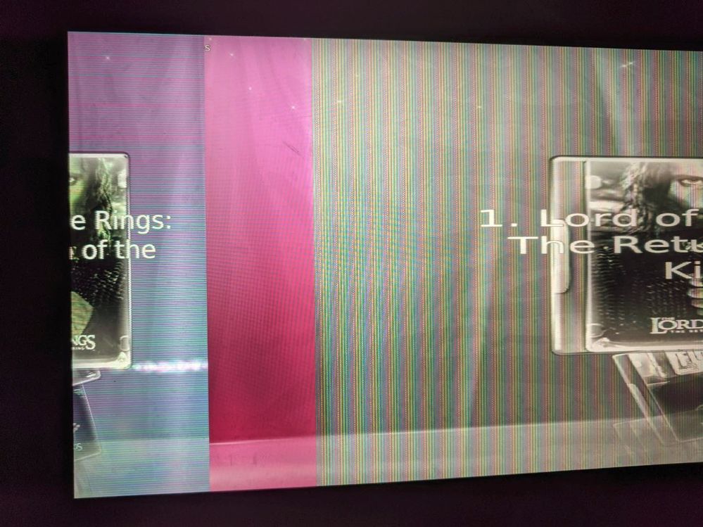

I have an IMX6 board with an LVDS display attached (split-mode).
I configured the mxcfb in this way:
     mxcfb1: fb@0 {
         compatible = "fsl,mxc_sdc_fb";
         disp_dev = "ldb";
         interface_pix_fmt = "RGB24";
         mode_str ="LVDS-WUXGA";
         default_bpp = <32>;
         int_clk = <0>;
         late_init = <0>;
         status = "disabled";
And the timing in this way:
    lvds-channel@0 {
         reg = <0>;
         fsl,data-mapping = "spwg"; /* "jeida"; */
         fsl,data-width = <24>;
         crtc = "ipu2-di1";
         primary;
         status = "okay";
         display-timings {
   timing_wuxga: LVDS-WUXGA {
                clock-frequency = <149992500>;
                hactive = <1920>;
                hback-porch = <20>;
                hfront-porch = <100>;
                hsync-len = <18>;
                hsync-active = <0>;
                vactive = <1200>;
                vback-porch = <4>;
                vfront-porch = <6>;
                vsync-len = <2>;
                vsync-active = <0>;
                de-active = <1>;
                pixelclk-active = <0>;
Now, if I start the kernel with parameter in uboot like:
video=mxcfb0:dev=ldb,1920x1200M@60,if=RGB24,bpp=32 ..
The image start with an high clock (like ~190MHz), this because it use the VESA CVT formula.
It obviously is out of clock, with bad timing etc.., but with the fbset command:
/usr/sbin/fbset  -g 1920 1200 1920 1200 32  -vsync 0 -t 6667 20 100 4 6 18 2
I get a perfect image.
Point: until the device is not started, and the fbset executed I get a bad image, but after executing this command everything is configured correctly.
If i remove the uboot param:
The default parameter is taken from device tree, I get the correct fbset configuration:
mode "1920x1200-60"
    # D: 149.993 MHz, H: 72.883 kHz, V: 60.134 Hz
    geometry 1920 1200 1920 2400 32
    timings 6667 20 100 4 6 18 2
    rgba 8/16,8/8,8/0,8/24
endmode
But the image is not good (see attached image).
Executing fbset command in this case doesn't change anything, the image is bad.
I think that is a clock problem or something like this, the timing correct.
Question: What the VESA CVT formula change other than timing and resolution? How I can set it in devicetree or in uboot? There is some clock change that I can made?

cristiansicilia
Thank's for reply weidong.sun‌ ,
as I said I configured it in split-mode, so I'm using two LVDS channels with one display.
Anyway if I start it with u-boot parameter
it start calculating timing with VESA CVT formula, and I get a bad timing and bad clock, but configuring it with fbset after start-up it work good.
So the Display working perfectly, but I need to start it with a VESA CVT mode, and then changing it after startup.
But seems very nasty, I would start it with the right configuration from boot.
But using the parameter in the DTS, all timing is correct (see fbset output), but the image is bad (see image in the post).
There is something in the VESA calculation that will fix something.. but what?
What I miss to configure in my dts?
Clock base? ...?
