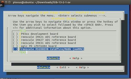

I am trying to use LTIB to build a RFS for an IMX28 embedded Linux build.  The project is an older project (circa 2010) that I am trying to re-build on a Ubuntu 17.
After much effort, I was able to get LTIB (version 13.2.1) to give me a prompt; however, it doesn't have IMX28 as a selectable option.  Is there a different version of LTIB I should be trying to use?
