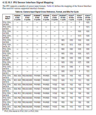

how to change the signal mapping pins of 8 bits yuv format for Imx6q?
3,170 Views
MrHoon89
I want to change the signal mapping pins in Table 62. Camera Input Signal Cross Reference, Format, and Bits Per Cycle.
Our hardware is as follows.
So, we must use CSI0_DATA[11:4] for 8bits yuv format.
But, only CSI0_DATA[19:12] should be used in the IPU Sensor Interface Signal Mapping.
We must change the pins from CSI0_DATA[19:12] to CSI0_DATA[11:4].
What should i do?
Please help me!

pls refer to the data sheet, for yuv 8bits, connect to the high 8bits
2,752 Views
MrHoon89
Do you mean that it is impossible to change the pins from CSI0_DATA[19:12] to CSI0_DATA[11:4]?
2,704 Views
joanxie
yes, I think so
