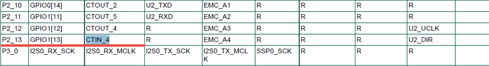

I am currently using the LPX-link2 for signal collection. And would like to add a external trigger feature. I read the post LPC-link2 external trigger for HSADC jeremyzhou‌ ravithakur and follow the instruction, I have done bellowing:
1. import the zip file and change the main function into jeremyzhou's code, then build and run it in debug mode
2. trigger it using a 3 V DC signal, with half second on and half second off, but the LED not turn on
3. check P1_13 by using GPIO mode, which shows that is the correct pin.
I am a bit confused and will be very appreciate if anyone give a clue in how to make it work.

I currently have a small piece of code that can do data collection using LPC-link2 in software trigger mode. I would like to sync this to function generator with a external trigger signal. Then I found your suggestion of using COUNT_n as the trigger, for instance CTOUT_0. The SCT can detect external signal of I/O as event, then the event can arise the SCT_CTOUT_n output high or low level, in this postLPC-link2 external trigger for HSADC. I follow the instruction, but I may not setup correctly and cannot get it to work. Below is the code from the previous post:

I using the pin1_13  and input the 3 volt step signal, but the SCT event does not triggered. I am very grateful to get any suggestion / clue that what I have done wrong.
Chuangnan

jeremyzhou
Hi Chuangnan Wang,
Thanks for your reply.
The CTIN_4 is assigned to P2_13 pin, not the P1_13, please check it.

chuangnan_wang
Hi jeremyzhou‌,
Sorry for the confusing, I do mean pin2_13, and I check it on GPIO1_13.
