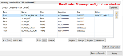

Hello Team,
Here I've attached two files of memory configuration, both bootloader and application.  With this configuration it is not jump into the application.  It is continuously rebooting, please check and let me know the solution for this issue.

Omar_Anguiano
Hello
I hope you are well.
Please use the release configuration for building the bootloader.
The configuration is correct although I suggest you double-check it through the linker files.
It is also important to check that the bootable image is correct, you might refer to this AN: AN12238: i.MX RT Flashloader Use Case – Application Note (nxp.com)
Omar
