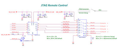

For JTAG Remote Control , What are the hardware changes to modify on  I.MX8MPLUS EVK?
2,057 Views
Manuel_Salas
Hello @Bhardwaj

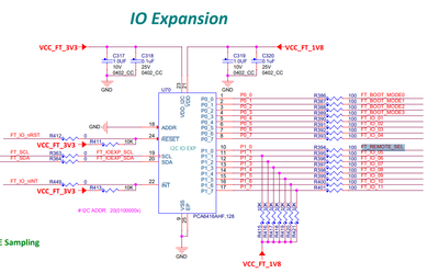

The JTAG Remote Control is controlled by signal REMOTE_SEL from FTDI IC.
You can take a look to this link about of remote debugging (i.MX93 as Example).
Salas.

we are using the prebuilt image given for SD card and booted the board from SD card. After stopping in uboot we have given the commands.
As you said we enabled the REMOTE_SEL pin using the below command
sudo .././bcu_Ubuntu20 set_gpio remote_en 1 -board=imx8mpevk
Then we have given the below command to check the remote debug is working or not
sudo src/openocd -s ./tcl -f interface/ftdi/imx8mp-evk.cfg -f board/imx8mp-evk.cfg
