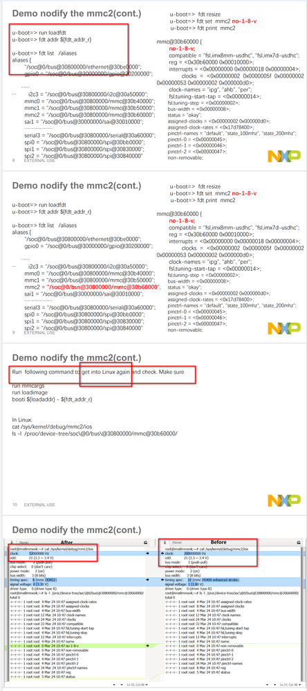

Are you sure u-boot can't modify the Linux device tree?
a. u-boot has the fdt command that can modify the Linux device tree.
Your colleague also has documentation on this.
Here is the document:
u-boot runtime modify Linux device tree (dtb)
https://community.nxp.com/t5/i-MX-Processors-Knowledge-Base/u-boot-runtime-modify-Linux-device-tree-...
b. arch/arm/mach-imx/imx8m/soc.c uses the same API as the u-boot fdt command.
c. Isn't u-boot supposed to prepare the Linux runtime environment? Any operations, including modifying the Linux device tree, must occur before Linux boots.
After u-boot loads a Linux device, but Linux hasn't booted yet, can't it modify the Linux device tree?
The simplest question is: Isn the "disable_cpu_nodes" API function before or after Linux boots?
We really need clarification from NXP on these issues as this is relevant to the projects we are actually running.
Could you please review the source code?

hogole
@Chavira
This is your suggestion:
Please double check your references, the U-Boot device tree is not the same as the Linux device tree, and changes made to one do not automatically apply to the other.
Now I double check the reference and using different color to highlight:
6,158 Views
hogole
@Chavira
We discussing the u-boot modify the Linux device tree, not modify u-boot device tree.
And the code https://github.com/nxp-imx/uboot-imx/blob/lf-5.10.72-2.2.3/arch/arm/mach-imx/imx8m/soc.cdoes the same as u-boot fdt command does.
In the u-boot runtime modify Linux device tree (dtb) is using u-boot command to modify the Linux device tree.
From page 8 to 11, It is clear shows the u-boot modify the Linux device tree and boot into Linux.
6,134 Views
