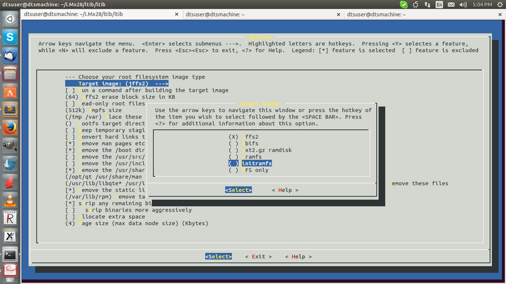

I installed ltib on a virtual machine with ubuntu 12.04 (I don't find how to do with newer version) and now I can compile with ltib.
I genrerate initramfs and use it on my usual toolchain to generate updater_ivt.sb (with my own zImage and bootlet). Unfortunately, It doesn't work and I have this log when I execute mfgtool :
0x8020a01d

pt
Senior Contributor I
Generate image of type initramfs.
Pt
5,846 Views
