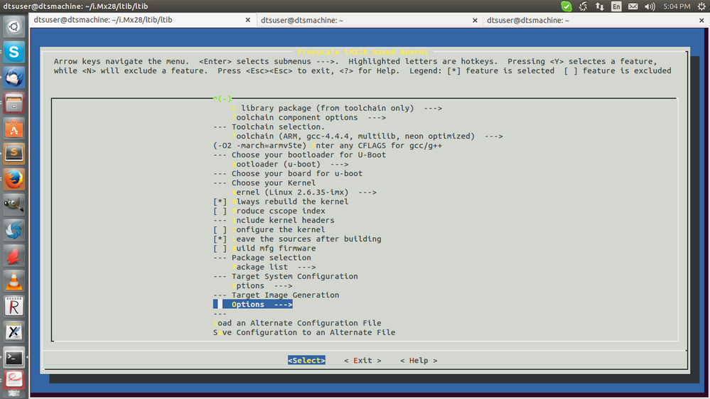

Now I can generate updater_ivt.sb with ltib and it works on my board with mfgtools.
The download and programming work few time. But now the process always fails after the boot and the board is seeing as "Linux file storage gadget USB device" on mfgtools.
How resolve this problem ?

I installed ltib on a virtual machine with ubuntu 12.04 (I don't find how to do with newer version) and now I can compile with ltib.
I genrerate initramfs and use it on my usual toolchain to generate updater_ivt.sb (with my own zImage and bootlet). Unfortunately, It doesn't work and I have this log when I execute mfgtool :
0x8020a01d

pt
Senior Contributor I
Generate image of type initramfs.
Pt
5,844件の閲覧回数
