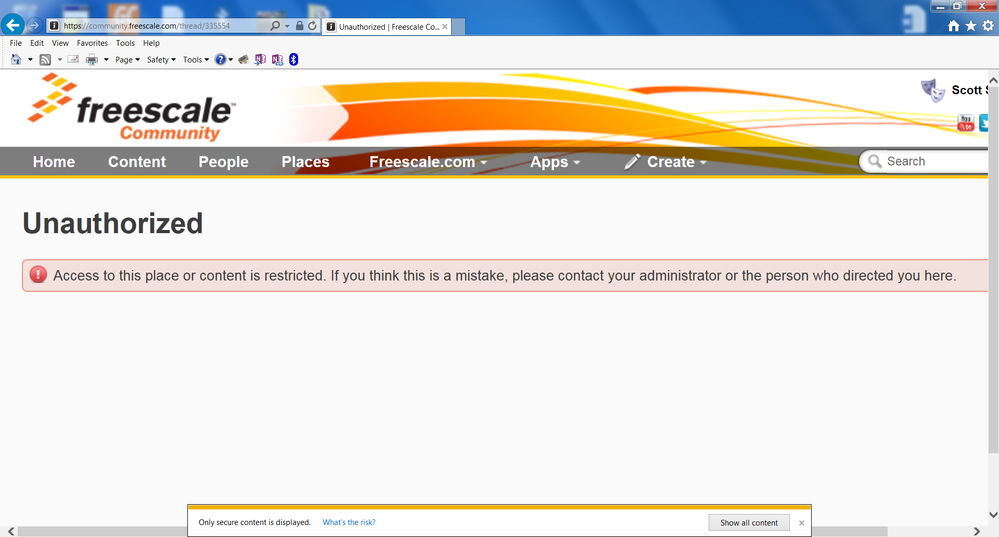

orangeusa
Uhh, no go - restricted content. (That's what the page says).
2,642 Views
takashitakahash
On restricted access to this content, I will not this feature.
Advice please.
2,642 Views
