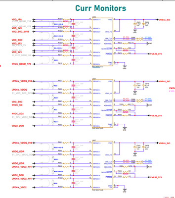

I am using iMX93 QSB with latest firmware ; Linux 6.6.36_2.1.0
I want to measure power of the Board using bcu tool, I am facing this error:
Please share how to resolve this
bcu eeprom -w -board=imx93evk11
Then you can choose to replace option <-board=> with <-auto>.
NOTE: If other boards are also connected to the same host, <-auto> may break its ttyUSB function temporarily.
pac1934_write_bipolar: pac 1934 failure get ack pac1934_snapshot: pac 1934 failure get ack pac1934_write_bipolar: pac 1934 failure get ack pac1934_snapshot: pac 1934 failure get ack pac1934_write_bipolar: pac 1934 failure get ack pac1934_snapshot: pac 1934 failure get ack pac1934_write_bipolar: pac 1934 failure get ack pac1934_snapshot: pac 1934 failure get ack pac1934_write_bipolar: pac 1934 failure get ack pac1934_snapshot: pac 1934 failure get ack pac1934_write_bipolar: pac 1934 failure get ack pac1934_snapshot: pac 1934 failure get ack pac1934_snapshot: pac 1934 failure get ack pac1934_snapshot: pac 1934 failure get ack PAC1934 cannot access!
done
version bcu_1.1.52-0-g17ab144 board model is imx93evk11
>>>>>> Registered FTDI EEPROM on board >>>>>>
Invalid EEPROM context, use -w option to write the default values.

I am facing the same issue "pac1934_write_bipolar: pac 1934 failure"
If I run board= imx93qsb
sudo ./bcu monitor -board=imx93qsb
Gives me Capture time, but does not give the Current and Power

Hello @emb-dev
This is expected, because in the imx93EVK board we have Current monitors to measure the lines:
You can refer to the i.MX93EVK schematics on page 12.
The QSB has not those current monitors, but it has the PCA9655EMTTXG port expander, that it can control the BOOT_MODE, Reset pines to reset board and boot from an specific device.
If you want to measure the lines I recommend to you to use the i.MX93 EVK (A0 or A1 are supported in BCU).
I hope this information can helps to you.
Salas.
