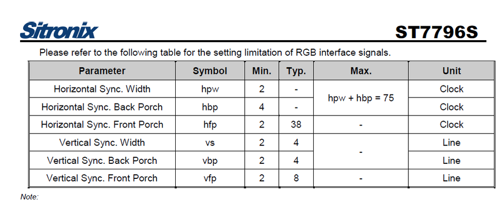

purendra_singh
Thanks Igor
I have been provided initialization sequence for the LCD by vendor. When I went through the ST7796s driver's datasheet and matched the sequence I found out that
1.VFP (Vertical front porch):- 0x08
2.VBP (Vertical back porch):- 0x08
3.HBP (Horizontal Back porch):- 0x64
have been set in the sequence by using the command BPC(B5): Blanking Porch Control but didn't get Horizontal front porch value, hsync_len and vsync_len.
I am taking reference from below link to calculate the pixel clock :-
https://community.nxp.com/t5/i-MX-Processors-Knowledge-Base/Setting-i-MX8M-Mini-and-Nano-MIPI-DPHY-C...
Also I have got the table below, can I take Horizontal front porch value, hsync_len and vsync_len from this table. Which values should I take ? Please suggest.
Thanks.

igorpadykov
Hi purendra_singh
for new MIPI-DSI lcd one can start with imx8mm-evk-rm67191.dts
https://source.codeaurora.org/external/imx/linux-imx/tree/arch/arm64/boot/dts/freescale/imx8mm-evk-r...
add specific for that lcd initialization in driver : struct cmd_set_entry manufacturer_cmd_set[],
timings in struct drm_display_mode default_mode
https://source.codeaurora.org/external/imx/linux-imx/tree/drivers/gpu/drm/panel/panel-raydium-rm6719...
