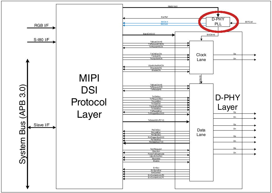

The D-PHY PLL (in the red circle in the picture below) is the PLL that drives the MIPI Clock lane. It must be set in accordance with the video to be sent to the display.

Bit clock calculation (clock lane)
The mipi-dphy bit_clk is the output clock and is calculated on file sec-dsim.c (line 1283):
sec-dsim.c\bridge\drm\gpu\drivers - linux-imx - i.MX Linux kernel
Bit clock can be calculated with the following equation:
bit_clk = Pixel clock * Bits per pixel / Number of lanes
