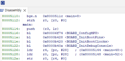

Hello
I'm a developer using  IMX RT1020 EVK  board.
I created a project to do SDRAM-boot using ROM-Bootloader.
The default project uses lwip-ip4_ipv6_echo_freertos SDK Sample.
The Step is below,..
1. Modify code from [ fsl_flexspi_nor_boot.c ] in the xip folder
2. Project Properties -> From Managed Linker Script.
   Check the Plain load image & select BOARD_SDRAM to automatically create the build linker script
3. Uncheck the Managed Linker Script
4. From Debug Directory,  [ evkmimxrt1020_lwip_ipv4_ipv6_echo_freertos_Debug.ld ] Modification
5. start-up folder start-up_mimxrt1021.c code modification
and build , Flash programming.
Finally ,    This project  could not  do Boot
What is the problem ????  Please Check this project (evkmimxrt1020_xxxxx.zip)
But. With Same sequece,   attached project (RAMBOOT_exam.zip) is  Successfully SDRAM Working !!
      What is the difference..  ?? What do I omit   ??
Please check this 2 projects,   and      How can I do SDRAM boot   by this method ?
Please someone,  help me.

Hi @Seongyon_Jeong
I hope that you are doing well!
I ran the RAMBOOT_exam project you have, it can get succesfully loaded into SDRAM also debugged. I can not compile your application.
I saw that your app  is a client and the RAMBOOT_exam project is a server, apparently.  I would suggest you to generate the binaries of boot images, then, check if there is anything missing on your app image with regards to the flash configuration block, IVT and DCD areas.
I have not seen the process for RAMBOOT documented by us. But if you want to simply generate a bootable SDRAM application you can follow this post made by one of my collegues:   I.MX RT - How to boot to SDRAM. The difference with this article and your procedure, is that we rely on the MCU boot utility to generate a complete bootable image. Then the image gets loaded using serial downloader mode. If you are in a hurry you can follow this process.
