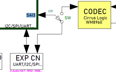

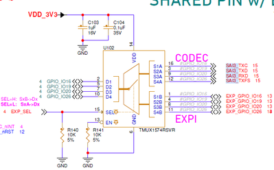

I wish to connect a device with I2S output to an imx93evk.
Since I want I2s directly and not with a codec in the middle, I don't need to do anything since by default the pins will be in the EXPI.
I then connected the device to the following pins:
I am setting in the pin mux for the GPIO 18, 19 and 20.
Can you please confirm if my understanding is correct? Currently I can't read any value, but I am not sure if it is a wrong assumption on the HW or a faulty i2s driver.

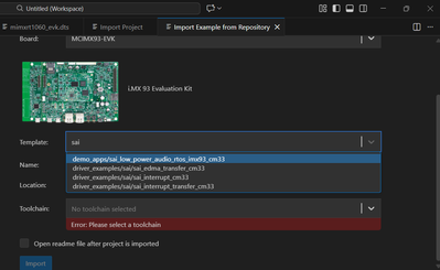

hello @rti
Have you had any progress ?
For I2S examples on Cortex M33, you can refer to examples under the SDK that you can build here: https://mcuxpresso.nxp.com/
Here are the examples:

I made some measurements:
- BCLK has the right voltage level and frequency (0 - 3.3V)
- Frame Sync has an oscilation similar to the BCLK which is strange. I am expecting the FrameSync pin to be High or Low voltage for the number of bits we need to read and not oscilating at the same frequency of BCLK. Also the voltage level is not right, always around 500-600mV, where the High and Low should be above and below ~1.5V
When I make the physical values deserialization with an osciloscope it is also all interpretred as 0, with different message length (due to bad frame sync) and always low voltage.
It is clear to me now that the problem is the registers configurations for SAI3. Can you please provide support with an application note on tx/rx with I2S usage?
