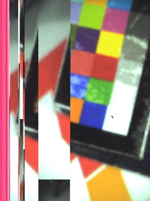

I'm developing a Qt application for the i.MX8MP targeting a 12MP image capture device and encountering image artifacts in the captured PNG images.
Hardware/Software Environment:
  • SoC: NXP i.MX8MP
  • Camera: 12MP sensor via MIPI CSI-2 (CSI1)
  • Framework: Qt with GStreamer
  • Capture resolution: 4048x3040
GStreamer Pipeline:
c
descr = g_strdup_printf("v4l2src name=video_source "
                        "device=/dev/video-isp-csi1 "
                        "io-mode=dmabuf ! "
                        "video/x-raw, width=4048,height=3040 ! tee name=t "
                        "t. ! queue max-size-buffers=1 leaky=downstream ! imxvideoconvert_g2d "
                        "name=g2d rotation=3 ! video/x-raw, width=480, height=800 ! appsink "
                        "name=app_sink_live max-buffers=1 drop=True "
                        "t. ! queue ! appsink name=app_sink_snapshot max-buffers=1 drop=True");
Issue: The captured PNG images frequently contain visual artifacts (see attached image). The artifacts appear as corrupted regions or visual distortions in the final image.
Observations:
  • MIPI CSI debug logs indicate the CSI signal appears to be stable and correct
  • The issue occurs intermittently but frequently enough to be problematic
  • Both the live preview path (with rotation and scaling) and snapshot path are affected
Questions:
  1. Could this be a buffer synchronization issue between the ISP and the downstream elements?
  2. Are there recommended buffer settings or pipeline configurations for high-resolution capture on i.MX8MP?
  3. Could the dmabuf io-mode be causing memory coherency issues?
  4. Are there any known issues with the ISP driver at this resolution?
Any guidance would be greatly appreciated!
