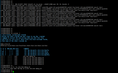

The /etc/net-debug.sh file is executed regularly in /etc/crontab, but now this script doesn't run. What is the reason?

xiang_1001
I can use the timing function by putting the crontab file into the /etc/cron.d/ file.
