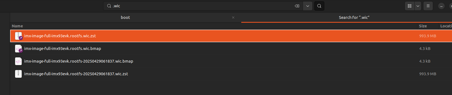

I have done bitbake-imx-image-full and in yocto_sdk/bld-wayland/tmp/deploy/images/imx93evk i see 2 wic file please go through the shared image.
Why the wic image name is imx93evk? i told like we are working with imx93 frdm board? can i use the wic file for imx93-frdm board?

Chavira
Hi @Et_MM!
Apparently you have configured the machine to imx93-evk
Try following the steps that we provide in our github.
#Install the repo utility:
$: mkdir ~/bin
$: curl https://storage.googleapis.com/git-repo-downloads/repo > ~/bin/repo
$: chmod a+x ~/bin/repo
$: PATH=${PATH}:~/bin
#Download i.MX Linux Yocto Release:
$: mkdir ${MY_YOCTO} # this directory will be the top directory of the Yocto source code
$: cd ${MY_YOCTO}
$: repo init -u https://github.com/nxp-imx/imx-manifest -b imx-linux-scarthgap -m imx-6.6.36-2.1.0.xml
$: repo sync
If errors on repo init, remove the .repo directory and try repo init again.
#Integrate meta-imx-frdm recipes into the Yocto code base:
$: cd ./sources
$: git clone https://github.com/nxp-imx-support/meta-imx-frdm.git
$: cd meta-imx-frdm
$: git checkout imx-frdm-2.0
Change to the top directory of the Yocto source code and execute the command below to setup environment for build.
#For i.MX93 FRDM
$: MACHINE=imx93frdm DISTRO=fsl-imx-xwayland source sources/meta-imx-frdm/tools/imx-frdm-setup.sh -b frdm-imx93
Run the command below to generate Yocto images:
$: bitbake <image recipe>
Some image recipes:
Image Name Description
imx-image-core core image with basic graphics and no multimedia
imx-image-multimedia image with multimedia and graphics
imx-image-full image with multimedia and machine learning and Qt
Best Regards!
Chavira
14,540 Views
Et_MM
Thank you for your reply. i am able to create wic file for imx93frdm board.
