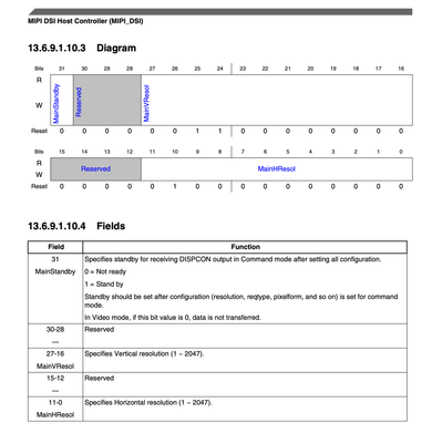

also when I look at the programming guide for the DSI I see a note saying the max resolution is "1-2047" . Is that correct? Or is is really 4095? There appear to be 12 bits allocated?
Screenshot 2023-05-01 at 2.33.33 PM.pngScreenshot 2023-05-01 at 2.33.33 PM.png
 this is from "
i.MX 8M Plus Applications Processor Reference Manual, Rev. 1, 06/2021"

so 1080x2160 should be supported, what kind of hsync issue do you get? did you measure pixel clock?
