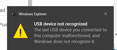

We have three customized IMX8MN boards. Now, we are trying to do the ddr training & stress test.
However, two of our boards are not recognized by the PC at all. Another one just got a warning of USB device not recognized. We already changed the boot mode to serial download mode.
Of cause we got the error inside ddr training and stress test tools:
ERROR: Can't open USB device!!!
Please check if the correct target is selected and set to the serial download mode
We are using the PMIC of PCA9450 with a 2Gb DDR4. Here is the power rail supply from the pmic I measured(when in serial download mode before firmware download):

Base on my understanding, the firmware download in ddr test tools(download into on-chip internal RAM) only needs the basic voltage(default config).
Where should I have a check in the next step?

Hi Jie
for that issue one can check sect.Table 8. USB recommendations, clock stability
using sect.Table 10. Oscillator/Crystal recommendations     i.MX 8M Nano Hardware Developer’s Guide

AccuJie
Thanks for your suggestion. We found out that the problem is from our oscillator.
