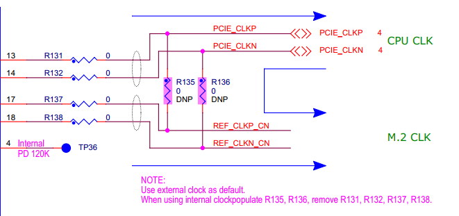

This is the frequency requirement,
The requirements are complient with the PCI specification as mentioned in the datasheet but you can have a reference is the design and device of 8M Plus' PCI reference clock generator.
Page 10 of schematic.
And 9FGV0241AKLF datasheet.

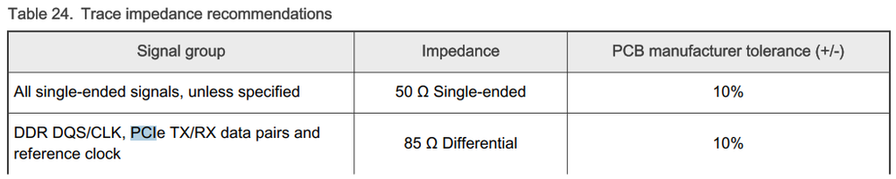

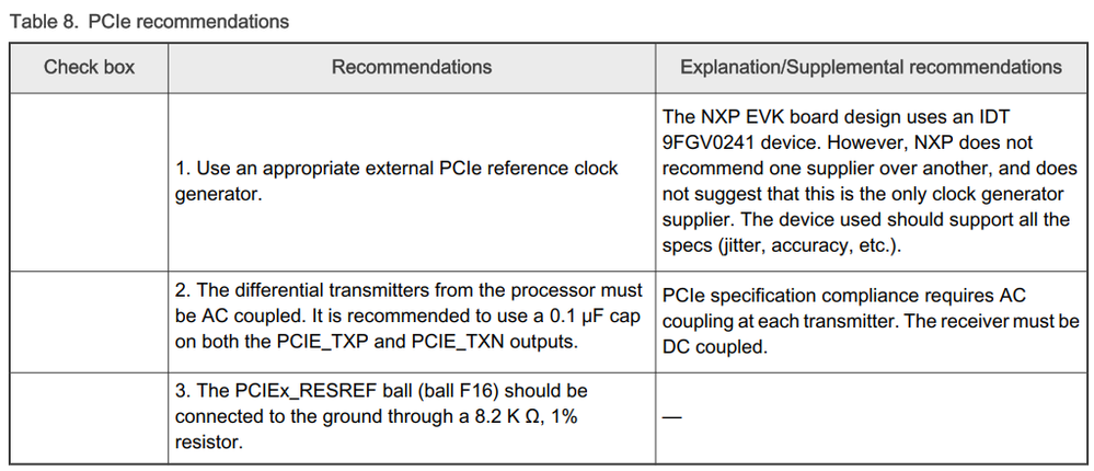

Here are the guidelines provided by the hardware developers guide:
And this is a backup found in hardware developers guide:
On EVK, a PCIE clock generator chip (9FGV0241) is used to feed high-quality clock to both the PHY and connecter/device. If a PCIE clock generator is not available, use the internal clock of the chip. Note that the internal clock exhibits larger jitter than that from PCIE clock generator
These are guidelines from a PCIe training:

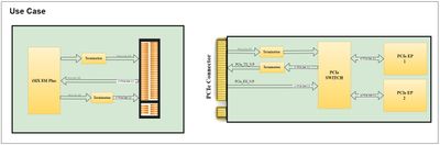

Hi @JosephAtNXP
Attaching our use case.
Use CaseUse Case
1) So which PCIe clock method is suggesting for us based on our use case?
PCIe ClockPCIe Clock
2) Which termination is suggesting for the PCIe clock?
Our concern about the clock is if we proceed with the method 2, then need to know about the clock type...then only we can provide corresponding clock termination/transformations. Refer the attached application note for this query.

As said, you can use internal clock or external clock in any application just considering that there may be a larger jitter, this increment can be in any application, and as you may see in schematics, there are no clock termination requirement, check that if internal clock'd be used, map M2 pins to processor pins.
