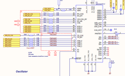

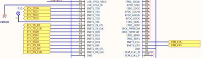

Good Afternoon,
I currently have a custom board with an iMX7d (On an EA iMX7d uCOM SOM) connected to a DP8360 PHY via MII and I don't seem to be able to get comms working properly over the MII interface. The PHY is discovered and configured correctly over the MDIO bus and I can see sent TX packets in wireshark from UBOOT. Hoping I've missed something in the device tree,
Schematic,
Current Device Tree,

igorpadykov
Hi James
one can look at dts file on link
https://community.nxp.com/t5/i-MX-Processors/Does-iMX7D-ENET2-support-MII-interface/td-p/1297656
also recommended to check enet clock with oscilloscope, it is configured in uboot setup_fec()
register IOMUXC_GPR_GPR1, described in sect.8.2.4.2 GPR1 General Purpose Register (IOMUXC_GPR_GPR1)  i.MX 7Dual Applications Processor Reference Manual

jameshall
Hi Igor,
Thanks for the link, I've rationalized my device tree (attached) against the one in the link you sent and updated my UBOOT to set the enet_clk to external,
clrsetbits_le32(&iomuxc_gpr_regs->gpr[1],
		 IOMUXC_GPR_GPR1_GPR_ENET1_CLK_DIR_MASK, IOMUXC_GPR_GPR1_GPR_ENET1_TX_CLK_SEL_MASK);
Still can't receive packets in UBOOT and now the PHY isn't coming up at all in Linux
James
