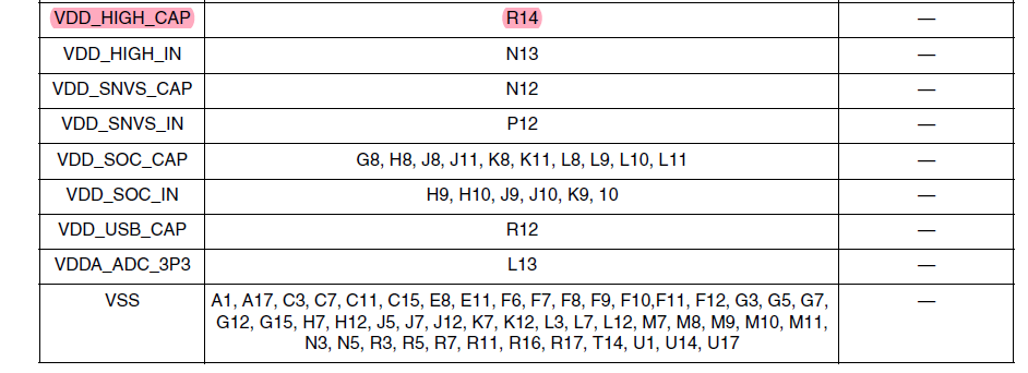

umasundaram
Thanks for the resources link.
   Can you please confirm the function of  pin "R15",of iMX6ULL.
Q1: Is it assigned to power "VDD_HIGH_CAP" or any other pins.
   Please find the image on Pg126 of IMX6ULL (Industrial grade) with R15 mentioned as "VDD_HIGH_CAP2".
 At page 115 of the datasheet,R15 is not assigned to any of the pins.
Uma

Yuri
  There are two pins VDD_HIGH_CAP (R14) and VDD_HIGH_CAP2(R15), that must
be tied together (and named VDD_HIGH_CAP). The doc team is informed about it.
   Also, please refer to the i.MX6ULL EVK design.
