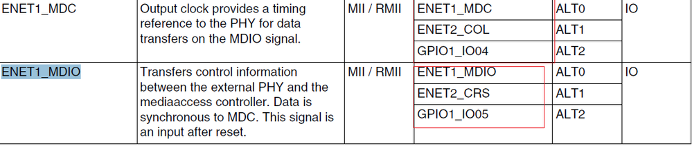

In i.mx6ul-evk,there is a picture below:
Could you tell me what function this pin "ENET1_nINT and ENET2_nINT" is, is this pin mapped to other pin or not?
If yes, which source file will we need modify in linux?

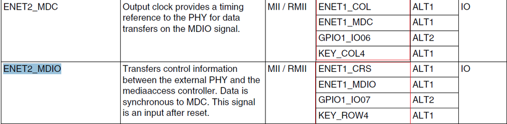

In this picture,Could you tell me what function this pin "ENET_MDIO and ENET_MDC" is, is this pin mapped to other pin or not?If yes, which source file will we need modify in linux?

(2)In this picture,Could you tell me what function this pin "ENET_MDIO and ENET_MDC" is, is this pin mapped to other pin or not?If yes, which source file will we need modify in linux?
--ENET_MDIO and ENET_MDC are management pins of Ethernet, From I.MX6UL reference manual, They can be routed via other PADs:
these 4 signals can also be configured in imx6ul-14x14-evk.dts, but on i.mx6ul evk board, use one MDC & MDIO to mange 2 Ethernet, see following, please:
        pinctrl_enet2: enet2grp {
            fsl,pins = <
                MX6UL_PAD_GPIO1_IO07__ENET2_MDC        0x1b0b0
                MX6UL_PAD_GPIO1_IO06__ENET2_MDIO    0x1b0b0
                MX6UL_PAD_ENET2_RX_EN__ENET2_RX_EN    0x1b0b0
                MX6UL_PAD_ENET2_RX_ER__ENET2_RX_ER    0x1b0b0
                MX6UL_PAD_ENET2_RX_DATA0__ENET2_RDATA00    0x1b0b0
                MX6UL_PAD_ENET2_RX_DATA1__ENET2_RDATA01    0x1b0b0
                MX6UL_PAD_ENET2_TX_EN__ENET2_TX_EN    0x1b0b0
                MX6UL_PAD_ENET2_TX_DATA0__ENET2_TDATA00    0x1b0b0
                MX6UL_PAD_ENET2_TX_DATA1__ENET2_TDATA01    0x1b0b0
                MX6UL_PAD_ENET2_TX_CLK__ENET2_REF_CLK2    0x4001b031
So if you want re-map them, you can modify above 2 lines with Bold.
