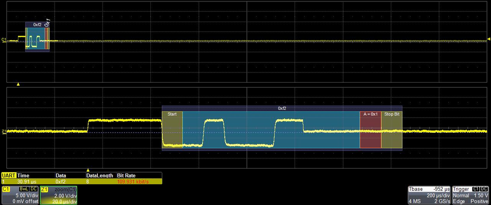

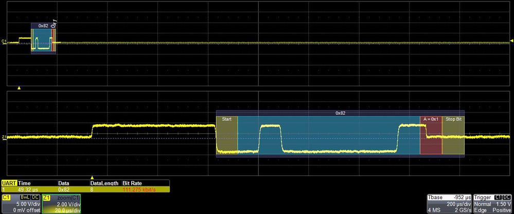

When looking at the first byte being sent (buf[0], 0x02) on scope i see the following when i do not include the sleep:
When running once again:
So it seems to be some kind of race condition, the data is always different.

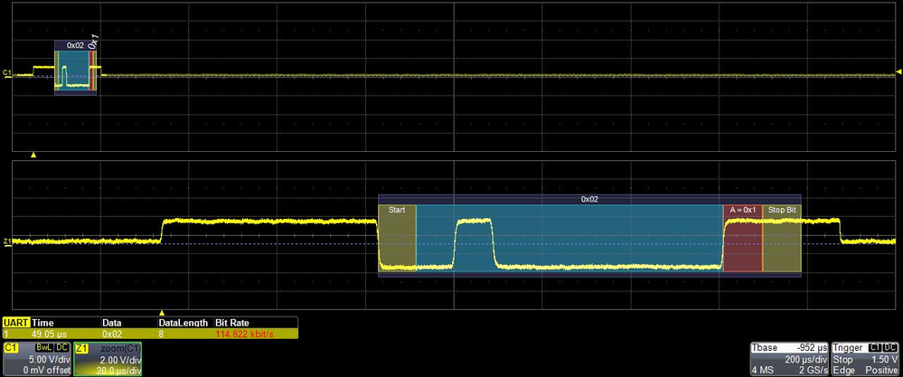

When i do enable the sleep(1) function i always get the following (correct) result:
I was hoping to find someone here who has knowledge of how to debug this or what the possible problem could be.
