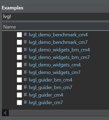

Hello Everybody,
Im working on IMX1176 & Custom LCD TFT LCD (not mipi). İs there any example about this subject?
Thanks for all
1,546 Views
EdwinHz
Hi @tbayram,
I recommend you to refer to our GUI Guider/lvgl example codes, as they are well suited for the RK055HDMIPI4MA0 and RK043FN02H-CT TFT LDC displays that we ship with our i.MX RT devices. You could do so either using GUI Guider as described on this community post: https://community.nxp.com/t5/GUI-Guider/To-dumb-on-a-TFT-disply/td-p/1714007
Or directly from the SDK on MCUXpresso by importing an example from the "lvgl_examples" subfolder:
I would highly recommend using GUI Guider as it is great and user friendly tool for using display technologies with our i.MX RT family.
