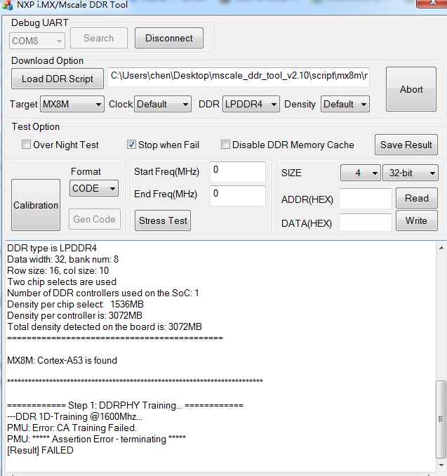

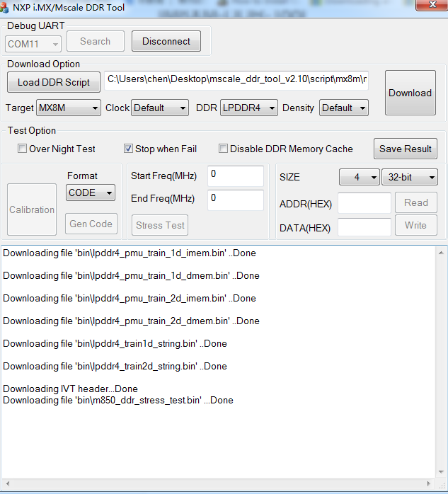

Hello all:
        The correction DDR is normal on the common board, but abnormal below appears on my own board correction
         Press Download button and to appear as shown below
I'm sure my board is in download mode,also A “HID-compliant device” or “USB Input Device” will be shown in the Device Manager as Figure

4,593件の閲覧回数
1316244577
Hi igor:
      I have a DDR of the same model with different memory, now 3G and 4G can be corrected, when I press Calibration to do DDR Training  1G and 2G will have the following error, why? I use the same one DDR script (DS  file)
4,593件の閲覧回数
igorpadykov
you should create special DDR script (DS  file) for used memory using
MX8M_LPDDR4_RPA_v23.xlsx tool from link:
i.MX8 MSCALE SERIES DDR Tool Release (V2.10)
then follow p.9 sect.4. Load DDR initialization script and choose correct downloading options
MSCALE_DDR_Tool_User_Guide.pdf

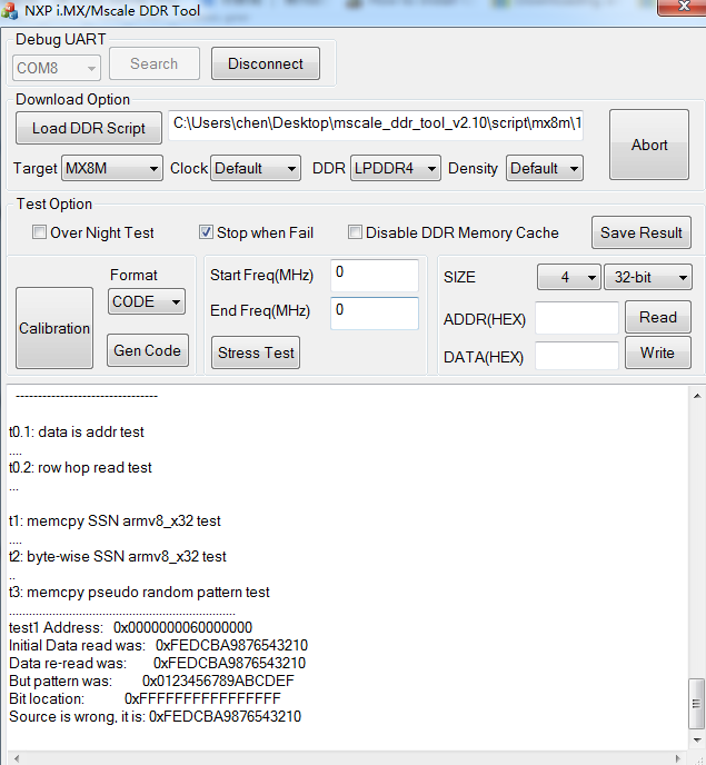

1316244577
Hi  igor ;
When I did the stress test it showed this fail,
LPDDR4 memory (MT 53 B 512M32 D2) ;How to modify DS file?
Do you have the 2GB LPDDR4 script?
4,593件の閲覧回数
igorpadykov
one can look at sample scripts in /script/mx8m folder of mscale_ddr_tool_v2.10
tool.
igor
