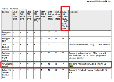

I was referring to the document IMXVIRTUG_ga  - i.MX Virtualization User's Guide
The document mentions the steps to boot and run Linux and Android simultaneously using Xen on I.MX Quad Max EVK board
1. Can the same steps and files be used to boot Linux and android on I.MX8 Quad Max MEK board?
2. Can the same steps be used to boot android automotive (14/15) with Linux using XEN?

Rita_Wang
For your qustions:
1\No, for the guide just use for this version Linux Virtualization 4.14.98_4.11_0.10 GA (Based on Linux 4.14.98_2.0.0 BSP)
2\No, as you can see that in the released BSP that for the android 14/ andorid 15 do not support the XEN on the i.MX8QM, just support on the i.MX95.
And for the automotive adroid BSP do not support it.
