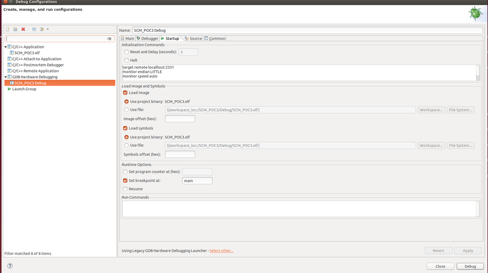

Hello all,
I finally found the correct set up:
Then I try to connect to JLinkGDBServer from Eclipse with the following debugger settings:
Run->Debug configurations:
     Debugger tap
          GDB setup
               GDB command: gcc-arm-none-eabi-4_9-2015q1/bin/arm-none-eabi-gdb
               Command set: srtandard
               Protocol version: mi
               Verbose console mode: not checked
          Remote Target:
               Use remote target: checked
               JTAG device: Generic TCP/IP
               host name or IP address: localhost
               port number: 2331
     Start up tap:
          Reset and deley seconds: not checked
          Halt: not checked
          Commands:
               target remote localhost:2331
               monitor endian LITTLE
               monitor speed auto
          Load Image and Symbols:
                Load image: checked
                     Use project binary: SCM_POC3.elf
                     Image offset (hex):
                Load symbols: checked
                     Image offset (hex):
          Runtime Options:
               Set program counter at (hex):
               Set breakpoint at: main
               Resume: not checked
               Run commands: none
Everything else was correct. It seems debug reset is not supported on the cortex-m as it is stated in the RM:

oscargarciafico
Hello Sam,
Next you can see my configuration. This is for Eclipse Mars.2. I didn't try this with older eclipse versions. You can se the "Reset and delay" checkbox at the top of the image.
I hope this solve your problem.
Oscar.

samsiddiqui
Oscar,
Now I see. For the debug configuration, I was using the 'GDB SEGGERJ-Link Debugger' option, which doesn't have a reset and delay option. I will use the 'GDB Hardware Debugging' option. I am using Windows, and I am assuming that I will first manually start the Segger J-Link GDB executable, and see which port it is using, and I can enter that info into Eclipse.

ERROR: Can not read register 8 (R8) while CPU is running
ERROR: Can not read register 9 (R9) while CPU is running
ERROR: Can not read register 10 (R10) while CPU is running
ERROR: Can not read register 11 (R11) while CPU is running
ERROR: Can not read register 12 (R12) while CPU is running
ERROR: Can not read register 13 (R13) while CPU is running
ERROR: Can not read register 14 (R14) while CPU is running
ERROR: Can not read register 15 (R15) while CPU is running
ERROR: Can not read register 16 (XPSR) while CPU is running
ERROR: Can not read register 17 (MSP) while CPU is running
ERROR: Can not read register 18 (PSP) while CPU is running
ERROR: Can not read register 24 (PRIMASK) while CPU is running
ERROR: Can not read register 25 (BASEPRI) while CPU is running
ERROR: Can not read register 26 (FAULTMASK) while CPU is running
ERROR: Can not read register 27 (CONTROL) while CPU is running
ERROR: Can not read register 32 (FPSCR) while CPU is running
ERROR: Can not read register 33 (FPS0) while CPU is running
ERROR: Can not read register 34 (FPS1) while CPU is running
ERROR: Can not read register 35 (FPS2) while CPU is running
ERROR: Can not read register 36 (FPS3) while CPU is running
ERROR: Can not read register 37 (FPS4) while CPU is running
ERROR: Can not read register 38 (FPS5) while CPU is running
ERROR: Can not read register 39 (FPS6) while CPU is running
ERROR: Can not read register 40 (FPS7) while CPU is running
ERROR: Can not read register 41 (FPS8) while CPU is running
ERROR: Can not read register 42 (FPS9) while CPU is running
ERROR: Can not read register 43 (FPS10) while CPU is running
ERROR: Can not read register 44 (FPS11) while CPU is running
ERROR: Can not read register 45 (FPS12) while CPU is running
ERROR: Can not read register 46 (FPS13) while CPU is running
ERROR: Can not read register 47 (FPS14) while CPU is running
ERROR: Can not read register 48 (FPS15) while CPU is running
ERROR: Can not read register 49 (FPS16) while CPU is running
ERROR: Can not read register 50 (FPS17) while CPU is running
ERROR: Can not read register 51 (FPS18) while CPU is running
ERROR: Can not read register 52 (FPS19) while CPU is running
ERROR: Can not read register 53 (FPS20) while CPU is running
ERROR: Can not read register 54 (FPS21) while CPU is running
ERROR: Can not read register 55 (FPS22) while CPU is running
ERROR: Can not read register 56 (FPS23) while CPU is running
ERROR: Can not read register 57 (FPS24) while CPU is running
ERROR: Can not read register 58 (FPS25) while CPU is running
ERROR: Can not read register 59 (FPS26) while CPU is running
ERROR: Can not read register 60 (FPS27) while CPU is running
ERROR: Can not read register 61 (FPS28) while CPU is running
ERROR: Can not read register 62 (FPS29) while CPU is running
ERROR: Can not read register 63 (FPS30) while CPU is running
ERROR: Can not read register 64 (FPS31) while CPU is running
WARNING: Failed to read memory @ address 0x00000000
Removing breakpoint @ address 0x009133DA, Size = 2
What Am I doing wrong?
Thanks in advance.
Oscar.
