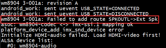

I'm porting the sound card wm8904 driver for Android 4.4.2, kernel version is 3.0.35, cpu is imx6q. I have some questions to ask everybody who know it:
1.I use tinyplay to test wm8904 driver.At a time when a song play over,I paly another right now.Then the system seems like blocking,and show some errors like that.I must wait about 20 seconds to play another.
2.When system start, it's shows some wrong:
Why failed to add route SPKOUT->EXT Spk, the sound card can work well on tinyplay?
3.How to write source code for Android Audio HAL?I
Under the 'hardware/imx/alsa' directory,there are many sound cards configure files for android,I copy config_wm8962.h to config_wm8904.h,and change some,here are my codes:

The android system can't play any songs,I test my driver with tinyplay,and it's work well.
So,How to code config_wm8904.h ? I'm very hopeless!!
That are my questions.Thanks very much.
