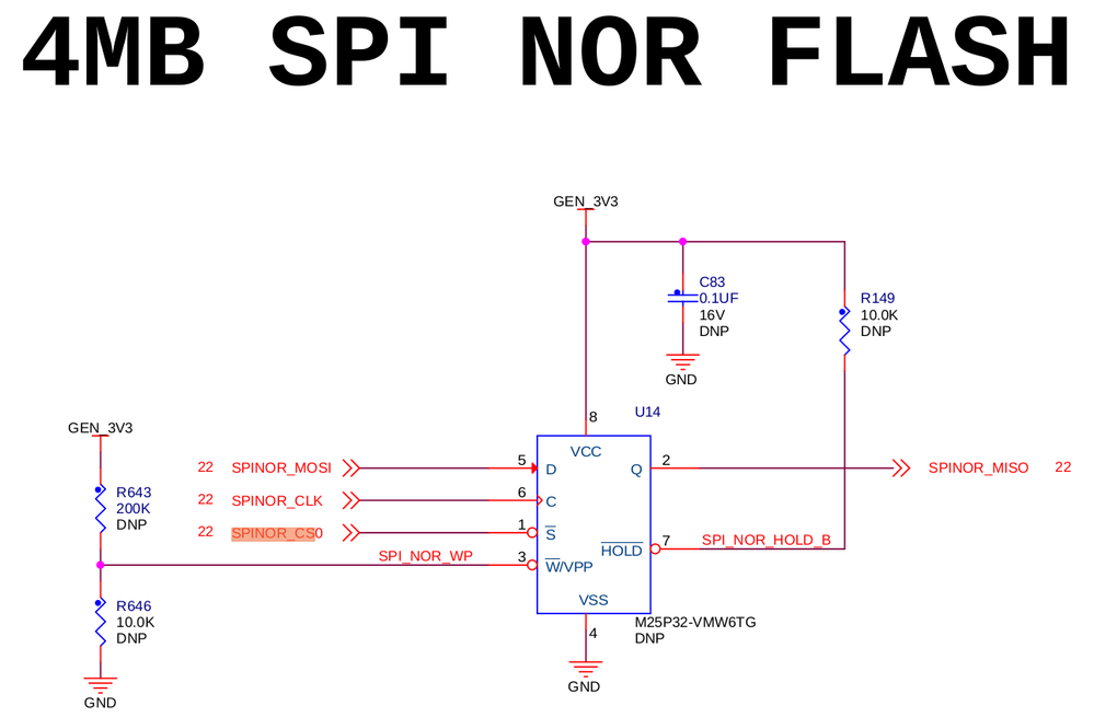

   My board is imx6q-sdb broad, I setting boot mode to SPI mode, after weld a spi-flash chip (U14, R643, R646, R149 C83, can see figure 1),  last flash an u-boot.bin to NOR Flash (use mfgtool), but can not load bootloader from SPI(always into download mode), please get me several suggest(is something missing?), thank.
NOTE:I believe SPI NOR has code(use mfgtool flash u-boot to NOR is success), will be into bootloader

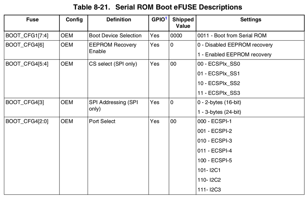

My config information:
 SBMR1 ---> 0x18000030
 BOOT_CFG1[7:4] --> 0011
 BOOT_CFG4[5:4] --> 01 - ECSPIx_SS1
 BOOT_CFG4[3]    --> 1 - 3-bytes (24-bit)
 BOOT_CFG4[2:0] --> 000 - ECSPI-1
figure 1
figure 2

Hi Lin
according to Table 14. Known issues and workarounds for i.MX 6 SABRE-SD
attached Linux Release Notes:
SPI NOR boot is not supported by the SABRE-SD board.
igor
