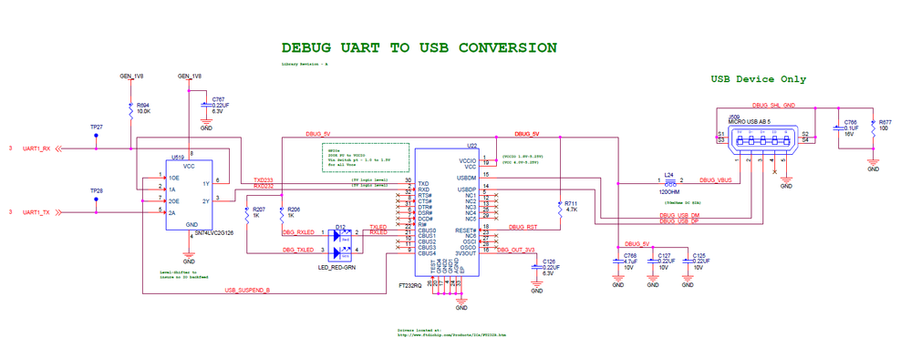

weidong_sun
hello,justin,
      On i.mx6 sabre sd SDB/SDP board, UART1 is used to be console and it has been converted to USB signal by FT232RQ. So you don't need to use USB to RS232 cable.
      You only need to connect a micro-usb to USB cable to USB host on PC. then open termial and boot the SDB/SDP board, booting messages will output your console.
      See schematic :
    It means FSL designers has done the job of usb to UART.
Weidong
