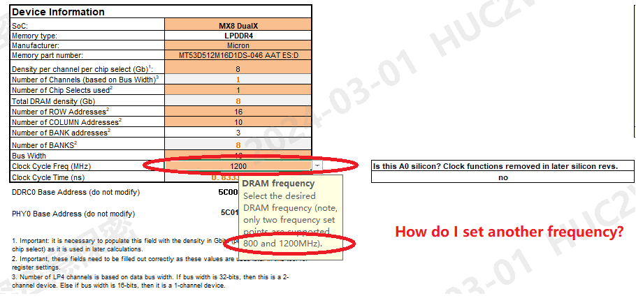

I have a question about DDR frequency setting. my hardware platform:
    SOC: imx8dx
    DDR: MT53D512M16D1DS
   (DDR model is consistent with the DDR Register Programming Aid)
When I used i.MX8QXP/DXP/DX DDR Register Programming Aid to set the DDR frequency, I found that clock cycle freq only 800M and 1200M could be selected in excel.
If I want to set the DDR frequency to 1100M, force off cell input validation and set the clock to 1100, is that OK?If not, how to set it

Because in our default BSP code, the board's DDR default start frequency is the same as the default in the RPA table, we cannot set all the frequency points in our RPA table. There are so many frequency point.

You can input the DDR frequency point.

I still have a question. As you described, if I can enter any frequency point, why can excel only select 800M and 1200M frequencies now
