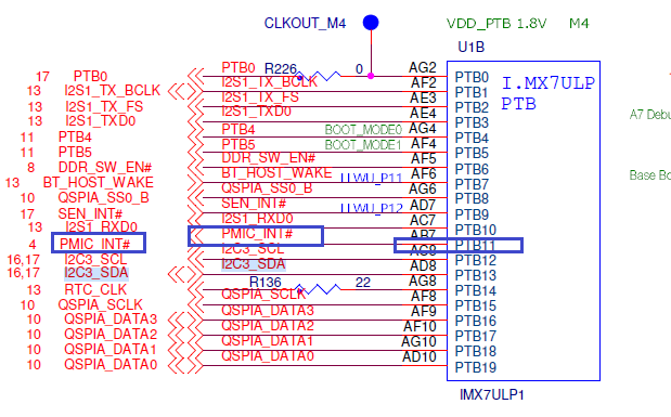

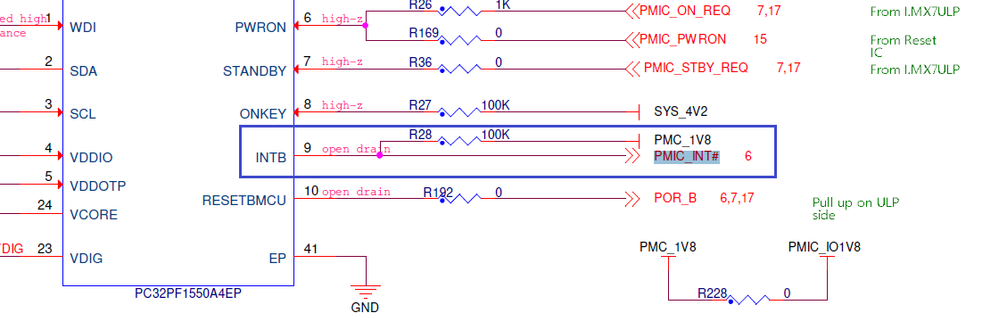

On i.MX7ULP EVK schematic, PMIC_INT is connected ot PTB11(Port B No.11 pin), see below, please!
The pin has been defined GPIO in imx7ulp-pinfunc.h
#define IMX7ULP_PAD_PTB11__PTB11                                     0x00AC 0x0000 0x1 0x0
If you want A7 to response it's interrupt in linux BSP, you should use the "Table 3-2. A7 interrupt assignments"
68 is IRQ number.

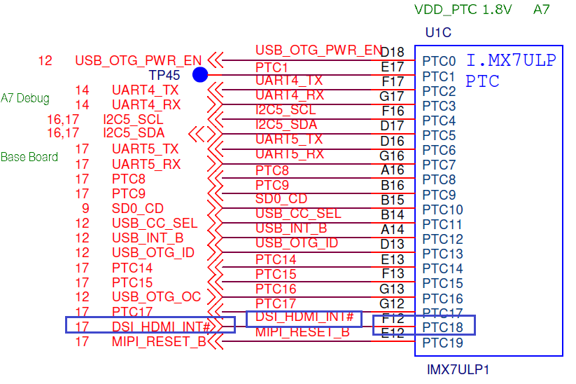

For detailed information on how to : Referring to interrupt of MIPI_DSI to HDMI .
        pinctrl_dsi_hdmi: dsi_hdmi_grp {
            fsl,pins = <
                IMX7ULP_PAD_PTC18__PTC18    0x10003    /* DSI_HDMI_INT */

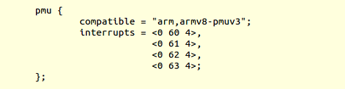

I'm familiar with the kernel configuration options needed and the device tree entries, my question is regarding the missing interrupt parameters in the PMU section of the device tree source file provided for the i.MX7ULP.
In the article you linked the device tree entry is:
But in arch/arm/boot/dts/imx7ulp.dtsi:
No interrupts are specified, as I said in my original question, I have tried to find information in the reference manual for the i.MX7ULP - the PMU IRQ doesn't seem to be available at the GIC (Generic Interrupt Controller) as it is on other i.MX platforms, but I saw some information that it might be possible to route the PMU interrupt to the CTI interrupt (which is connected to the GIC)?
Would this be possible, and is this the way it should be done to get access to the PMU IRQs or are they exposed in some other way?
David
