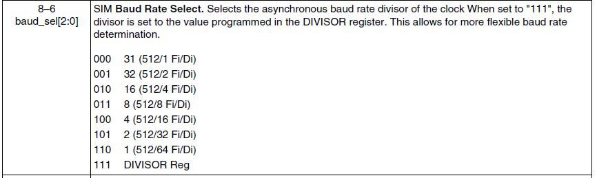

In IMX6UL.RM ch45, we set SIM Control Register bit 6~8 to determine baud rate.
My question is :

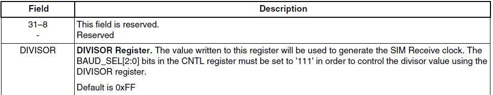

1. If i want to set flexible divisor, i need to set sim baud_sel  register to "111". And set the SIM Divisor Register.
    But i set any value to this register. It fail on data transmit. So, what value i need to set ?

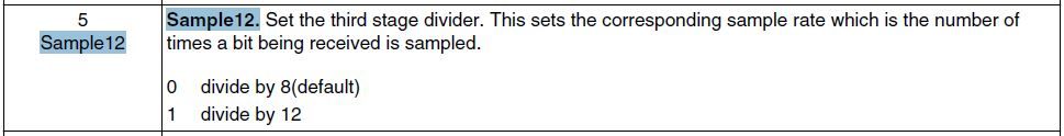

2. If i set the two register above, i need to set the sample12 register at the same time?
     If i enable this register, it means what value divide by 12 ?
3. Could you support me a way to set divisor with these register ??

from the team :
"i.MX6UL has passed EMV L1 pre-certification with simv2 driver and EMV L1 stack, TDA8035 is used as smartcard interface.
Micropross STAR 3150 hardware adapter and Integri’s INQ test software is used for pre-certification, which is the same as used in test laboratory appointed by EMV organization.
Baud rate configuration can be found in simv2 driver, which is in drivers/mxc/sim/ in linux release package (such as 4.1.15-r0),the related function is sim_set_baud_rate().
Currently only the value decribed in chapter 8.3.3.1 in EMV v4.3 Book1 is handled, i.e. F=372, D=1,2,4."
