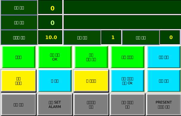

I am working with i.mx6quad qt5.
When I made application with korean font, it appeared like below.
Anybody can help me?

Dear karan,
I solved this issue as below.
I downloaded font and added to "sysroot/usr/lib/fonts"
That's it.

karangajjar
Senior Contributor II
Hi Coiln Park,
You need to set the QT_QPA_FONTDIR to the location of the font directory before launching the Qt application.
Please check out the below thread for more reference:
how to installing "segoe ui" fonts on to imx6qp yocto build
Also check Fonts section in Qt for Embedded Linux | Qt 5.14  .
