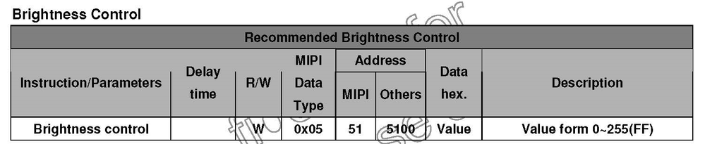

Hello ALL,
    i am using the OLED display (DLC0139AZOG-1) with imx6DL board,  i want to reduce the brightness of this display,
   for this i need to control the  SWIRE Pin which has address of ( 0x2Ah for mipi address) and i wrote in driver which is not
   change anything on display, please  any one can see the below code and tell me what wrong i did in the code,
   in the below code in macros is i changed some vaues i commented like //Brightness Related Start & End after changing
   those values while booting time display brightnes is less after complete the booting the display brightness is high,
#define HX8369_CMD_WRT_DISP_BRIGHT                (0x51)
#define HX8369_CMD_WRT_DISP_BRIGHT_PARAM_1            (0x80)
//FF up it was
#define HX8369_CMD_WRT_CABC_MIN_BRIGHT                (0x5E)
#define HX8369_CMD_WRT_CABC_MIN_BRIGHT_PARAM_1            (0x10)
//20 up it was
#define HX8369_CMD_WRT_CABC_CTRL                (0x55)
#define HX8369_CMD_WRT_CABC_CTRL_PARAM_1            (0x0)
//1 up it was
#define HX8369_CMD_WRT_CTRL_DISP                (0x53)
#define HX8369_CMD_WRT_CTRL_DISP_PARAM_1            (0x24)
//Brightness Related End

//SWIRE ADDRESS
        buf[0] = 0x2A;
    err = mipi_dsi_pkt_write(mipi_dsi, MIPI_DSI_GENERIC_SHORT_WRITE_2_PARAM,
        buf, 0);
    CHECK_RETCODE(err);
    /* Set power: standby, DC etc. */
    buf[0] = HX8369_CMD_SETPOWER | (HX8369_CMD_SETPOWER_PARAM_1 << 8);
    buf[1] = HX8369_CMD_SETPOWER_PARAM_2;
    buf[2] = HX8369_CMD_SETPOWER_PARAM_3;
    buf[3] = HX8369_CMD_SETPOWER_PARAM_4;
    buf[4] = HX8369_CMD_SETPOWER_PARAM_5;
    err = mipi_dsi_pkt_write(mipi_dsi, MIPI_DSI_GENERIC_LONG_WRITE, buf,
                HX8369_CMD_SETPOWER_LEN);
    CHECK_RETCODE(err);
/* Set display brightness related */
    buf[0] = HX8369_CMD_WRT_DISP_BRIGHT |
            (HX8369_CMD_WRT_DISP_BRIGHT_PARAM_1 << 8);
        buf, 0);
    CHECK_RETCODE(err);
    buf[0] = HX8369_CMD_WRT_CABC_CTRL |
        (HX8369_CMD_WRT_CABC_CTRL_PARAM_1 << 8);
        buf, 0);
    CHECK_RETCODE(err);
    buf[0] = HX8369_CMD_WRT_CTRL_DISP |
        (HX8369_CMD_WRT_CTRL_DISP_PARAM_1 << 8);
        buf, 0);
    CHECK_RETCODE(err);

static int mipid_bl_update_status(struct backlight_device *bl)
    u32 buf;
    int brightness = bl->props.brightness;
        printk(" MIPI LCD BL UPDATE STATUS:\n\n\n\n");
    struct mipi_dsi_info *mipi_dsi = bl_get_data(bl);
    if (bl->props.power != FB_BLANK_UNBLANK ||
        bl->props.fb_blank != FB_BLANK_UNBLANK)
        brightness = 0;
    buf = HX8369_CMD_WRT_DISP_BRIGHT |
            ((brightness & HX8369BL_MAX_BRIGHT) << 8);
        &buf, 0);
    hx8369bl_brightness = brightness & HX8369BL_MAX_BRIGHT;
    dev_dbg(&bl->dev, "mipid backlight bringtness:%d.\n", brightness);
    return 0;

nandishguruling
Hi igor,
yes i check with the DLC Datasheet they are mentioned in datasheet  this value
in Application notes they mentioned that
(2A80h) SWIRE Control
(8F80h) DIMCTR
(9080h) DIMCTRDP1
(9180h) DIMCTRDP2
(9280h) DIMCTRDP3
i tried all the above values in place of " HX8369_CMD_WRT_DISP_BRIGHT"
    err = mipi_dsi->mipi_dsi_pkt_write(mipi_dsi, MIPI_DSI_GENERIC_SHORT_WRITE_2_PARAM,
        buf, 0);
    CHECK_RETCODE(err);
but i am not seen any change in the display
Thanks in advance
nandish sg
9,028 Views

igorpadykov
Hi nandish
one can check OLED display DLC0139AZOG datasheet
for brightness commands.
igor
9,028 Views
