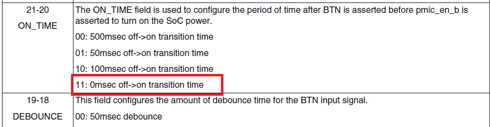

You should modify ON-TIME parameter from 500ms to 0ms from SNVS LPCR register.
I suggest you can parser imx-atf source code , and try to modified something as below.
imx/imx8m/imx8m_psci_common.c
void __dead2 imx_system_off(void)
mmio_write_32(IMX_SNVS_BASE + SNVS_LPCR, SNVS_LPCR_SRTC_ENV |
SNVS_LPCR_DP_EN | SNVS_LPCR_TOP | 0x00300000);
while (1)
