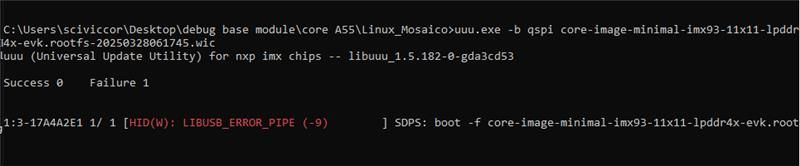

Hello everyone,
I'm tryng to flash into my custom iMX93 board with UUU the .wic. I'm using this built-in command:
uuu.exe -b qspi core-image-minimal-imx93-11x11-lpddr4x-evk.rootfs-20250328061745.wic
But it doesn't work.
The only thing that works is the bootloader. Indeed, when I use the following command:
uuu.exe -b qspi imx-boot-imx93-11x11-lpddr4x-evk-sd.bin-flash_singleboot
the bootloader starts, even if I reset the board with the boot mode configuration "FlexSPI Serial NOR", so I think it is correctly flashed into memory.
  1. What am I doing wrong with the .wic download?
  2. What am I supposed to do in order to flash the .wic file into QSPI-flash?
  3. Do I need to change something into the source files of the bootloader or it should be working as it comes from the nxp site?
Thanks in advance,
Bob
