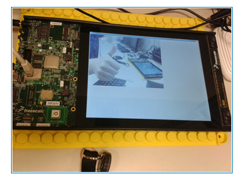

Now we are able to test our sample code, just a camera test and you can find the source code here: camera_test_sample
To build this application you need a new terminal window (all environment variables will be reset), then run the setup environment:
$ cd /opt/poky/1.5+snapshot/
$ . ./envionment-setup-cortexa9hf-vfp-neon-poky-linux-gnueabi
and then go to the camera_test_yocto folder and type make. The binary will be placed in the bin folder.
Once flashed your card with the Yocto image (opencv included), mount the sd card in your host computer and then copy the binary to your rootfs.
To test it, run the application with the following command:
$ DISPLAY =:0 ./camera_test
