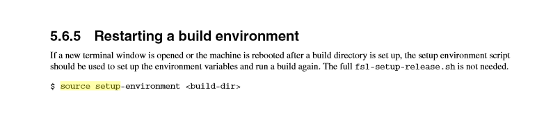

The step when you first do this:
repo init
repo sync
DISTRO=fsl-imx-xwayland MACHINE=imx8mqevk source fsl-setup-release.sh -b build-xwayland
bitbake xxx
But when you have done the above and exit the console then open a new console what is the right steps?
I need to run "DISTRO=fsl-imx-xwayland MACHINE=imx8mqevk source fsl-setup-release.sh -b build-xwayland" again to setup the environment variables. It looks good but the changes I have made to conf/local.conf have been overwritten, which is not a good way to do.
The question is how to do it gracefully and keep the things I have done before and set the environment variables correctly?

Hi wenfu ,
You have not mentioned which BSP version you are using. you can refer section 5.6.5 Restarting a build environment of i.MX Yocto project User's guide of respected version which you are using. For reference we have attached L4.14.98_2.0.0 version's i.MX yocto project user's guide.
So in your case you can give below command and then build image using $ bitbake xxx command.
                 $ source setup-environment build-xwayland

Hi Radhika,
wonderful ! You answer fully meet the need. I should have read the document carefully.
