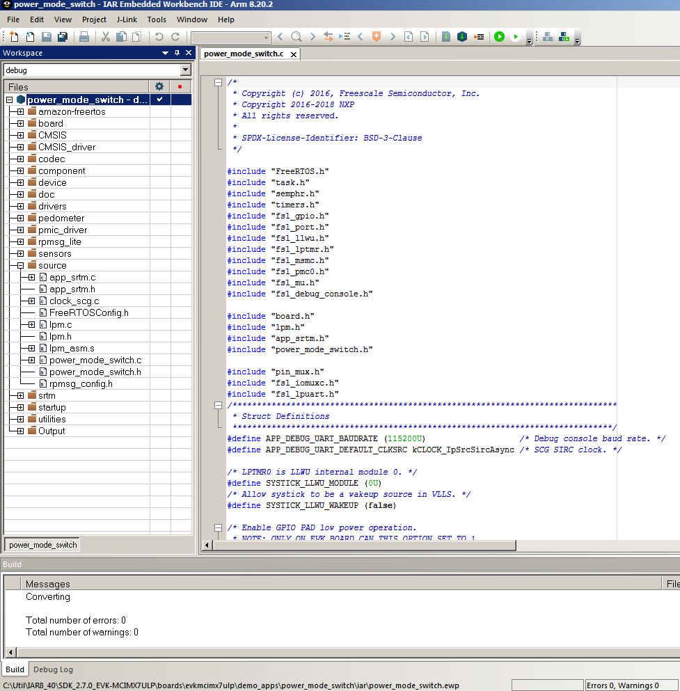

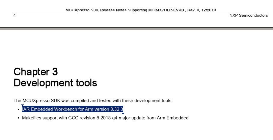

reason may be old IAR version as described in Release Notes,
I tried with IAR 8.20 it builds fine

You are absolutely right. I had not checked as it was working fine for other examples.
Thanks a lot!
