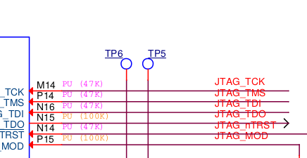

Pls, Can you suggest how to generate 8Mhz clock output using PLL in i.mx6ull processor.

Other than CCM_CLKO1,2 any other PLL pin possibilities to generate 8MHz clock out.
In above image CCM_CLKO1,2 are connected JTAG pins(JTAG_TMS and JTAG_TDO) Since JTAG  pins N15 or P14 has been used for 8MHZ clock, will that be conflicting when we use JTAG. So any other pins for 8MHz clock generate.

Hi prabhu
one can output "osc_clk" (24MHz dividing by3) on CCM_CLKO1,2 (look at sect.4.1.1 Muxing Options)
using CCM_CCOSR register described in sect.18.6.21 CCM Clock Output Source
Register (CCM_CCOSR) i.MX6ULL Reference Manual, configuring it in uboot.
