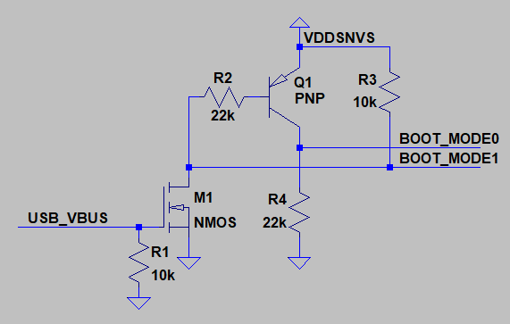

My customer is thinking about changing Boot-Mode by detection of USB OTG port.
The customer intends to make their proto-board with i.MX6Dual Lite and they intend to use i.MX6U with ‘internal boot-mode’. When they want to update their firmware, they want to USB OTG port into PC Host and firmware update can be done via USB OTG port using serial downloader-mode.
BTW, the USB port is used only for firmware update.
I think that changing boot-mode setting is needed (Internal boot-mode to serial-downloader-mode) by USB OTG attach detection. And some modification to hardware design and SW design will be needed.
Do you have any information on this?

Hi Miyamoto,
we have a board usually booting from NAND and when USB-OTG is plugged in it starts serial downloader.
BOOT_MODE0 has a pull-down and BOOT_MODE1 has a pull-up to VDDSNVS. On USB connection, BOOT_MODE0 is set high using a small PNP transistor and BOOT_MODE1 shorted to GND using a small FET.
Really simple and works just fine.
 Martin

mahi
Hi Miyamoto,
you can have that circuitry - it's really simple...
 Martin

SLICE
Hello Igor,
Thanks a lot for your prompt reply.
They intends to use eMMC for boot, so I think it is needed to modify hardware which can detect
attach USB cable and changing BOOT_MODEx pin setting.
Correct?
Miyamoto
