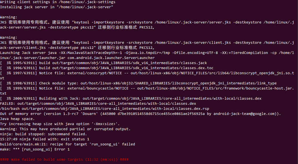

I am downloading Android O8.0.0_1.0.0 (Linux 4.9 kernel) , something is wrong :
Start fetching the source for android build
Fetching projects: 0% (2/596) aosp/platform/packages/inputmethods/LatinIMEfatal: unable to connect to git.freescale.com:
git.freescale.com: 没有与主机名关联的地址
imx-firmware:
I know that git.freescale.com is no longer valid, but how can I solve this problem?
Labels (3)
7,831 Views
ttttttx

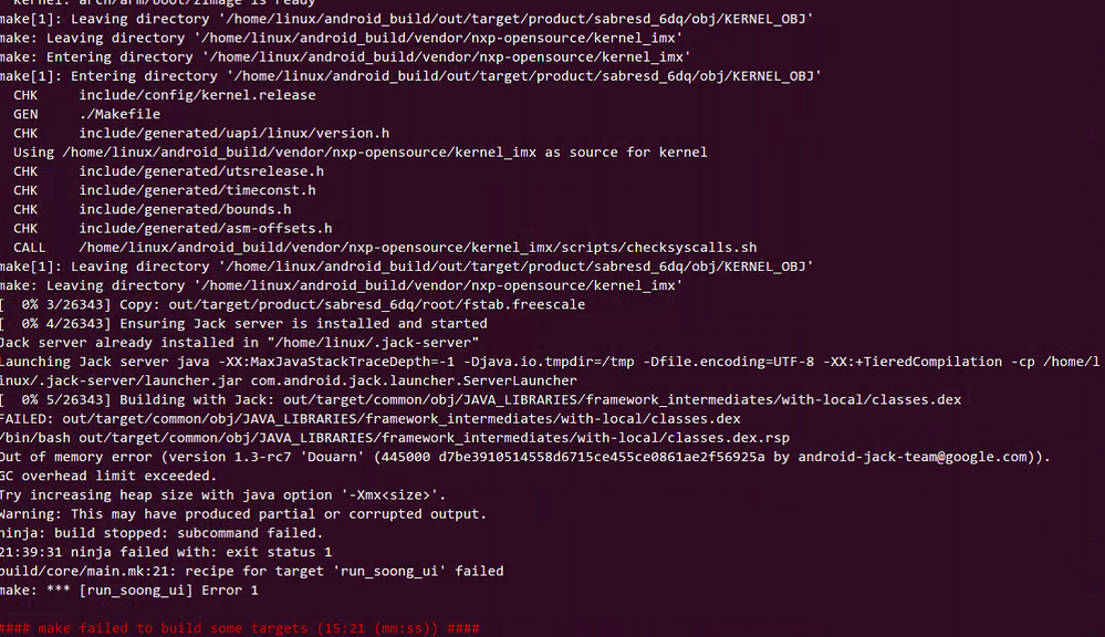

I found a tutorial and share it with everyone :
//https://blog.csdn.net/pan0755/article/details/77817244
linux@ubuntu:~/android_build$ export JACK_SERVER_VM_ARGUMENTS="-Dfile.encoding=UTF-8 -XX:+TieredCompilation -Xmx4096m"
linux@ubuntu:~/android_build$ ./prebuilts/sdk/tools/jack-admin kill-server
linux@ubuntu:~/android_build$ ./prebuilts/sdk/tools/jack-admin start-server
linux@ubuntu:~/android_build$ make 2>&1 | tee build-log.txt
Now : #### make completed successfully (01:32:02 (hh:mm:ss)) ####
