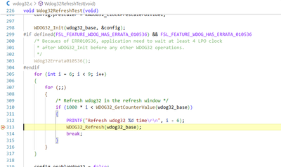

Can you share where you set the breakpoint? I set here and don't see watchdog reset.

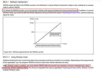

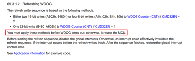

The refresh cycle cannot be stopped. If it is stopped, the counter will stop being cleared. When the counter is full, an interrupt is triggered to reset it. So you should not set breakpoint in that loop.

-->If you set breakpoint in refresh loop, this will stop feeding watchdog, causing reset.The debug flag is not used to debug watchdog step by step, that flag make sure watchdog can work under soc debug mode.

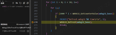

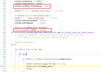

I add these two lines and set breakpoint in WDOG32_Refresh
Zhiming

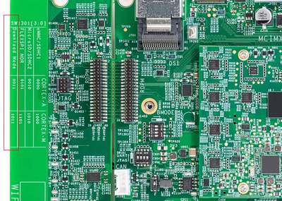

Can you try the a53 download mode or m33 download mode ? And the previous test is based on Debug , not Attach.
Zhiming
2,511 Views
leoX
Could you explain it more clearly? Do you mean using the serial download mode? Thanks.
Best Regards.
2,367 Views
Zhiming_Liu
Hi @leoX
Yes, currently i am using coterx-a download mode.
Zhiming
2,279 Views
leoX
Hi Zhiming,
Do you mean using the uuu command to download the bin file to the m core?
Best Regards.
