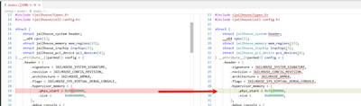

The imx-jailhouse/configs/arm64/imx93.c file defines the root cell configuration for the i.MX93 platform.
The default configuration works on the i.MX93 EVK board with 2GB RAM. However, my custom i.MX93 board has only 1GB RAM, so I need to modify the Jailhouse memory layout accordingly.
After modifying the Jailhouse memory layout, I conducted tests but encountered a kernel hang during execution.

I have determined that modifying the hypervisor_memory parameter consistently results in a kernel hang during execution. This issue has been verified through testing on the i.MX93 EVK platform.
Why is it not possible to modify the hypervisor_memory parameter?
